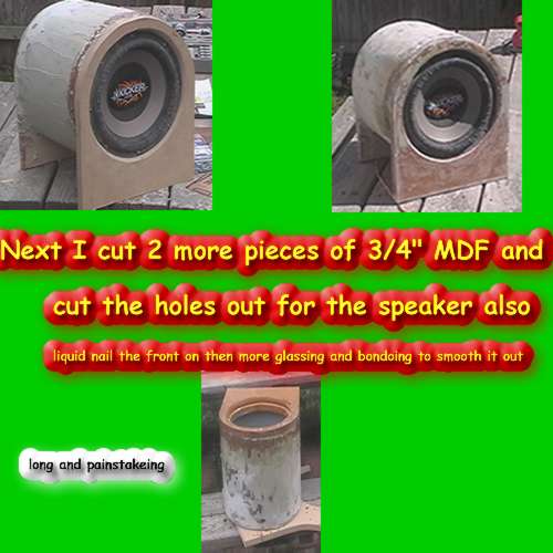

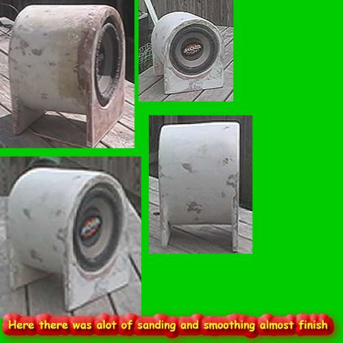

Here is my first fiberglass enclosure.  Its almost done but here is start to finish.First time fiberglass enclosure -- posted image.

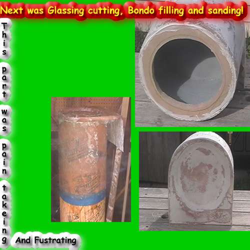

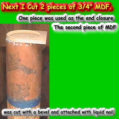

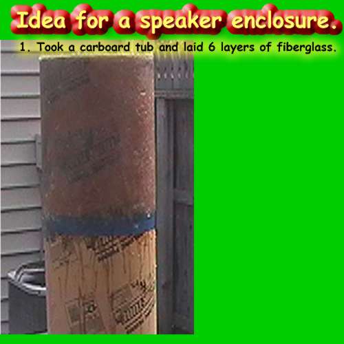

Sorry here are the rest of the pics!!!!
Well I don't think its not bad for the first attempt at doing a fiberglass enclosure.  I am up for some tips for my next one I do.

the tube is 12.5" in diameter and 11" in length.  I decide to do a tube enclosure instead of anything else.  I used the tube as part of the enclosure to get me the perfect cylinder size with out it colapsein.  Its pretty strong.

I'm getting fustrated I am sanding and sanding and i am having a hard time getting rid of the imperfections.  what can i do to fix the little imperfections I have used body filler.  What else can i do, just keep sanding?

What kind of imperfections? Pin holes, dips, low spots what?
Pin holes, coat the surface with glazing putty, real real thin coat. Got any pics?

I have a couple of pin holes couple of dips and low spots.  the only thing I can think of that is causing the low spots and dips is from the card board tube when I glassed it.  The only pics I have right now are the ones above.

Keep filling the lows and sanding the highs! The least fun part about making FB sutff!
If you are using Walmart bondo, do yourself a favor and get some good stuff, like rage gold or half time. They do not bubble and pin hole and sand like a dream. A gallon of rage is about 28 bucks retail at autobody supply house.
As for the pin holes, you gotta get some spot glazing. It is ready mixed and ready to use right out of the tube. Do not get too big of a tube unless you know you can use it up and put it on THIN.
Try to use someting flat to sand with, keep from cutting finger dents in it. With your project being round, you need a roll of emery cloth in 60 and 120 grit. It aint cheap but last forever. Tear you off a long peice and "shoe shine" your tube. That way you can avoid the finger dents.
Sand and fill sand and fill sand and fill...........
Thats what is all about!
Rick H...

Oh yea, after you apply a cost of putty and it is ready to sand, break the surface first with some cheap sand paper.  It will sand better and won't clog your good paper.
