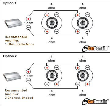

Should I hook it up 2 ohms or 4 ohms to this amp? Would it over power the two 10" that i have if I hooked it up 2 ohms? Would it be better SQ @ 4 ohms?

What? kfr01 he can't hook them up at 2-ohms.
Nismo350z:
Your only wiring choice is 4-ohms.
Amp power to subs -- posted image.
That amp should pound those *very* nicely.

Yep, wire each in series seperately, then parallel together for a 4 ohm load on the amp. The amp will put out the 800 that the subs will take.

alright i see what your saying, What i meant was should i run the subs @ 1 ohm, i was too hung up on speakers. Yea I'll probably run them at 4 thanks for the advice btw Perfect dvc10's Amp power to subs -- posted image. I love it right now with only 200 watts rms running through 1. Cant wait to hook up the other and with the mono block
