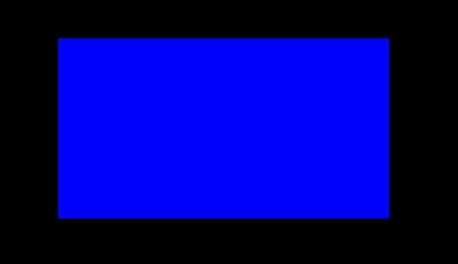

Alot of the dvd's you buy today are not actually 16x9 but a more animorphic ratio thats used in the theatres. Because of that a 16x9 monitor may still apear to have black bars on the tops and bottoms and the only way to fix that is to adjust the porportions in the way you mentioned. As for the bars on the side, it sounds like the monitor setting is on 4x3 not on 16x9 which is why you have the bars on the side. Change the setting to 16x9 and it will work fine.

Most widescreen dvd's are 2.35:1 ratio
16x9 is 1.85:1 ratio and your normal square is 1.33:1

I cannot get my AVIC-N1 to show 16X9 DVDs on the entire screen while the zoom settings are on "normal".  It will take up the whole screen if I switch to "just" or "zoom" but then the quality goes to crap.  You would think that a widescreen movie would take up the whole screen on a widescreen display but I guess that's not how it works with this one.  I know that's how it works at home.  The aspect ratio is set to 16X9.  I have tried different DVDs with different widescreen aspect ratios on two AVIC-N1s and it's all the same.
Here's an example of what my widescreen DVDs look like on "NORMAL".
Widescreen DVDs on N1 -- posted image.
Let me know if it's normal.
