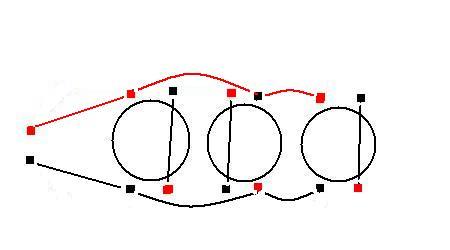

Example of reverse polarity on an inverted DVC sub using typical series/parallel wiring (the one in the middle is inverted between two normally mounted subs):
Reverse sub mounting question. -- posted image.
This type of wiring can get tricky because of a lot of factors:  number of subs in all, number that are inverted, the confusion factor caused by dual voice coils, etc.  Let the forum know what you plan to do and we'll look over your wiring.
