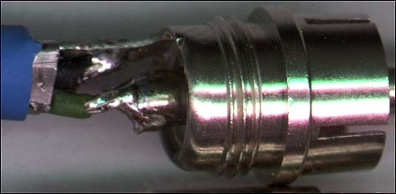

okay.  so I talked to the guy at the local install bay.  Apparently, all of the outputs on the factory unit are pre-amp.  wtf?  so technically, with some solder and wire I could make my own rca females, right?
I'm Rick James
stevdart
Platinum - Posts: 5,816
Joined: January 24, 2004
Posted: May 09, 2005 at 8:31 PM / IP Logged
I would think so.  You certainly couldn't hurt anything by trying it.  Give it a shot and let us know how it turns out.
1999 Navigator Questions -- posted image.
(pics stolen from http://www.bcae1.com/installationprimer.htm)
