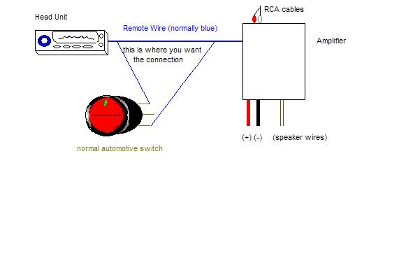

or you can still go with your vented box and just install a kill switch (just mount a switch on the remote wire form the HU to the amp) or get a bass control knob. Those will let you keep whatever bass setup you have for comp in the car while still using for everyday use. BTW, why are you in japan? Marine or Air Force?

I'm in japan because its a beautiful place, I was in the military, after I finished, I got married and desided to stay here. Now about the kill switch?? I don't understand the usage your talking about. please explain a little bit more.Kicker S15L7 sub enclosures yea or nea? -- posted image.

Yeah, I got out of Korea about a year ago. Go to an automotive store and buy a switch (any like you'd find in a car; normally found at like Autozone, advance auto, or discount auto but I don't think they have those in Japan.) then all you would do is place it on the remote wire running from the Head Unit to the Amp. I'll include a drawing of what I mean.
This is what I was talking about...I drew lines from the remote wire to the switch. so really all you're doing is breaking the circuit between the CD player and the Amplifier.

Then he would either have a comp setup or no setup at all. I think the bass knob is easiest answer here.
