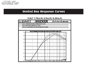

Jeff, any chance you can give up more room for the enclosure so that you can get it to 3.25 ft^3 plus port volume for each sub?  (...and rework the port size for two subs...)  This response shown in the Kicker MANUAL looks like a good one:
building box for l7's -- posted image.

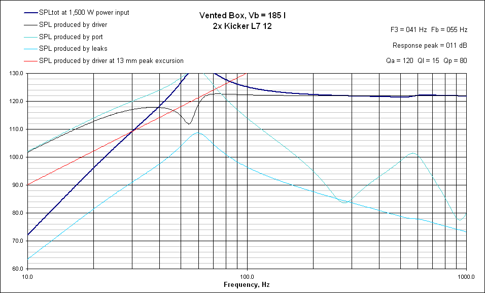

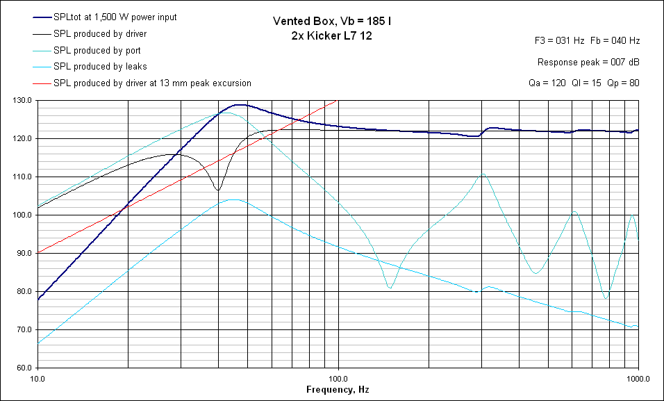

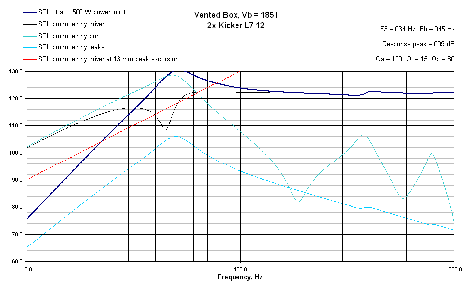

Jeff, just for the helluvit I worked these subs up in Unibox and looked at different tuning freqs.  For what it's worth to you I'll post links to .gifs showing the response and port size for two subs in one chamber.  You would need to double check me, though.
Tuned at 40 Hz, slot port opening area 95 square inches, 16.33" long.  vb_response_kicker_l7_12_40hz.gif
Tuned to 45 Hz, slot port opening area 95", 11.2" long.  vb_response_kicker_l7_12_45hz.gif
Greatest SPL at 55 Hz, slot port opening area 95", 4.8" long.  vb_response_kicker_l7_12_55hz.gif
( When these charts show up, an icon will eventually appear at the bottom right to expand the image.  It will be clear to read then. )
These are all with a single chamber of 6.5 cubic feet net.  Single port, no port noise.  And I'm supposing that you will be wiring series/parallel.  Now if I can just figure out how or if I can adjust the db range of these graphs to go over 130 db we can see how loud it gets!
