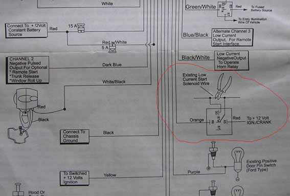

Hi all, I have Audiovox PRO-9342FT3 series alarm to be installed on 1997 civic. I have pretty much done except several wires. On the picture that is circled red, what is the "existing low current start solenoid wire" and where can I find it? And on the same place, for the output of pin #85 of the relay where it says to "+12 volts IGN/CRANK", it seems that this diagram shows that need to be connected to red wire of this alarm. Is this correct or should I connect this pin #85 to yellow wire (+12 volts switched ignition)?

Sorry, for some reason the picture didn't show up. Here's the alarm wiring.
Audiovox PRO9432FT3 on 97 Civic -- posted image.

Looks like your starter wire is BLACK/ white at the ignition harness. Test it first if it's the right one cut it in half and one side goes to 30 the other to 87a. The orange wire coming from the alarm is a grounded output any time the alarm is armed that is hooked to 86 as shown. Then you need power to energize the relay. This you get from a true ignition source which should be your BLACK / YELLOW wire in the ign harness. What they're saying when it shows  +12volts ign/crank is you need to make sure you have power on that wire thru crank. Other word trurn the key to the on position you should have pwr then to the start or crank position and pwr should stay.
HTH
