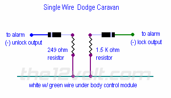

Was wondering if anyone could help me out. Close to blowing the darn thing up! I have a 98 Plymouth Voyager. Trying to connect a Bulldog Model Deluxe 500. Most of the connections were gravy, not the power door locks. Bull says that the ply is a one wire neg sys. I found the wht/grn wire that controls the locks. If I connect a 1.5 k resistor to a jumper from lock wire to short it locks and a 250 resistor it unlocks fine. Problem is that I can't seem to figure out how to cofigure the outputs from the module. I tried one at a time. Grn/wht wire from module to 1.5 resistor to lock wire. Will not lock. Tried with blu/wht on mod. to 250 resistor to lock wire will not unlock. Bull says to wire connector as a "type A pos". I also tried a relay with resistor, no help. The unit cliks with button pushed. Bull tech will not reply to e-mails. Can you guys help out?

Plymouth Door locks -- posted image.
Wire them like so.  I would prefer to use 2 relays myself.....

I just wanted to say thanks for the response I received to my question. You guys answered very quick and accurate. I discovered that if I had looked a little harder, I would have found the answer on your site. Thanks again.
