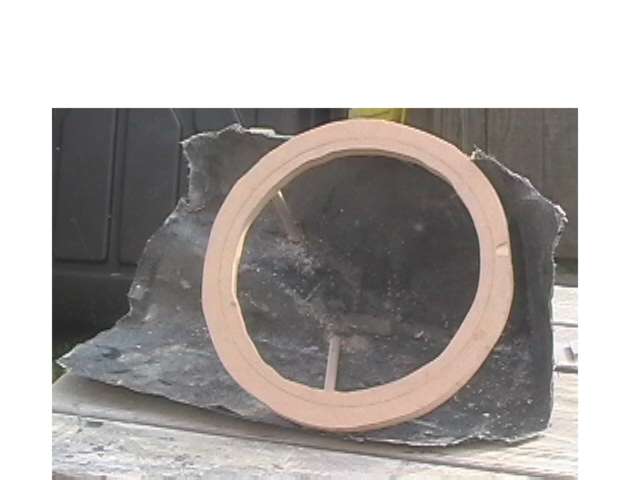

im just starting my project and was wondering how much resin do i need i want to make one to fit in the little section corner in my trunk like this one
I'm new, how much resin do i need? -- posted image.
i went to wal-mart only cause its close and i seen they have some stuff there and bought some fleece and a net wt of 2lb 3oz can of resin and comes with hardener for it would this be enoght or do i need to grab up some more.
thanks everyone for your time
j68rh
Copper - Posts: 147
Joined: March 31, 2005
Posted: June 19, 2005 at 4:05 PM / IP Logged
I am the one that did that project.  If I was you I would another can to do the project.  Also make sure you measure out right.  for every 4oz you use, use 1/4 tsp of hardner.  for going over the fleece thin out the resin a little with acetone.  when you mix the resin for the fleece I used 10oz of resin and 2 oz of acetone and 3 (1/4) tsp of hardener.  In a couple of days after I put the box in the car I will post a finished picture of both boxs the one for the sub and the one for the amp.
