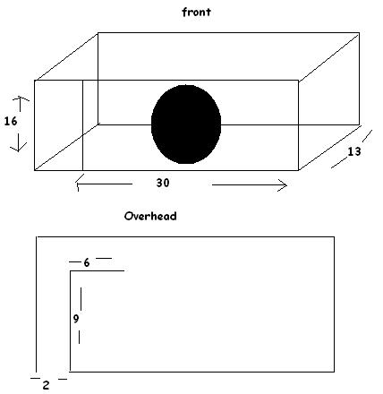

So, if i were to make a slot port box. can someone make me a overhead of how the box should look and explain the dimensions of the port?

k go to this page to get an idea of wat  a slot port looks like http://www.audiooutfitter.com/images/items/abb121n.jpg.
k the measurements i gave you were 6 by 2 by 9. so dat means the front square section dat u can see shud be 6 inches tall and 2 inches wide or it cud even be 12 inches and 1 inch wide. to work out da tallness of ur slot jus divide da required tallnes by 12 so if u wanted a 6 inch tall port u wud divide 12 by 6 and get 2..........and so on.
the extra 9 inch dimension means dat da port shud reach 9 inches from surface into the box. so ur box will be a 13 inch deep box and da port will reach 9 inches into da box

Making an enclosure for an idmax12 v.3 -- posted image.

the dimensions of the port are interior dimensions. so if u add da mdf, from one side to another the port will make 2 inch plus 0.75 by 2= 3.5inches wide.
but dont just use a whole new port, use the sides of the box to make part of the port
look again at the link of how the port is just the front piece cut short and an extra part added along inside which forms the port

thetruthc32

does this look right?

Posted: June 20, 2005 at 4:47 PM / IP Logged
nooooo
datrs wrongfrom da front da port will be 2 by 6 and da legth will be 9. so a prism of 6 by 2
