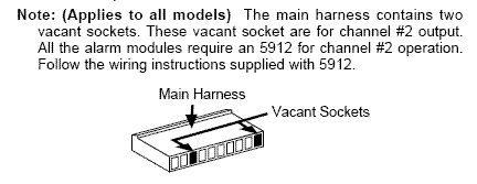

Hi,
My car has one remote system which install from dealer. It's Silencer 6918A
http://www.magnadyne.com/images/transfaxpdf/6900W.pdf
In the instructions, it says "All the alarm modules require an 5912 for channel #2 operation.
Follow the wiring instructions supplied with 5912."
I thought 5912 just a relay which plug into pin 3 and pin 10.
So I use a multi-meter to check the this two ping's Ohm and Volt. But it doesn't work when I press the transmitter blue (*) button.
Does anyone have idea with this module? I want add    Power Trunk Release function in my car. Thanks.

Posted: June 23, 2005 at 7:29 PM / IP Logged
Finally, I got answer by myself.
It can applie to Silencer 6908, 6908A, 6918, 6918A, 6928.
How to AddChannel #2 in Silencer 6918A ? -- posted image.
I bought a Auto relay from Radioshock and plug in and it works! Now I can press blue button 3sec then trunk will release. It's good to add more function in my old Silence module.
