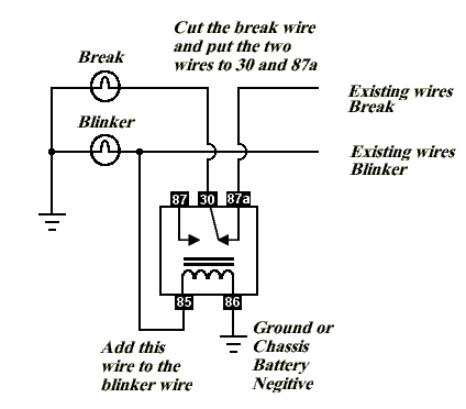

Alright, well here's my request: I own a 2001 Eclipse. For the tail lights, there are 3 circles on each tail light. One is a reflector, one is the brake light, and the other is a turn signal. Now when you apply the brakes and signal, the brakes turn on with the middle circle, while the turn signal blinks. Of course the reflector is just a reflector so that stays the same. What I want my tail lights to do instead of what I just stated above, is... Lets say Im signaling left (You are behind me). On my left tail light assembly, I want the brake light, and the turn signal light to interchange blinks while I signal. While my right tail light assembly stays all solid. I hope I explained this thoroughly enough, but please dont hesitate to post if you have any questions. TIA!

So when the breaks are on no blink and when the blinker is on alternate between blinker and break.
Make one of these for each side.

How can you get the blinker  and brake lite to alternate when the brakes are not applied.  In the above circuit the brake lite will not alternate with the blinker unless the brakes are applied.

This is true. That is just as requested in the post.
"Now when you apply the brakes and signal, the brakes turn on with the middle circle, while the turn signal blinks. Of course the reflector is just a reflector so that stays the same. What I want my tail lights to do instead of what I just stated above, is... Lets say Im signaling left (You are behind me). On my left tail light assembly, I want the brake light, and the turn signal light to interchange blinks while I signal. While my right tail light assembly stays all solid."
Tell me how you want it to act. The more you add the more complicated it gets.
If you add a hot wire to 87 it will blink Alternately unless the break is on, then it will not blink because there is a hot on both 87 and 87a.

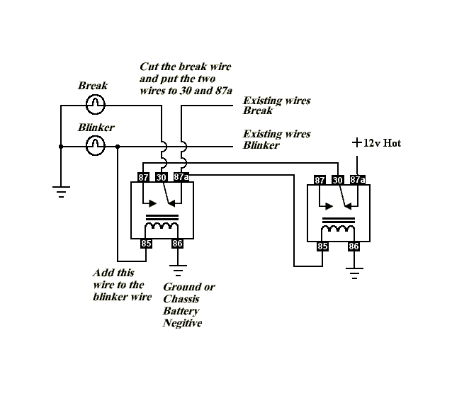

Here is a way you could do it with 2 relays on each side. But they will blink in tandum instead of alternating.

What is the curcuit required, such that when the blinker is actuated, that the rear blinker and brake lite will alternate between each other when the brakes are applied and also when the brakes are released?
If the 4 way flasher happens to be actuated at the same time, will that cause a problem?

These Diagrams take time to figure out.
Let me work on it awhile. The 4 way blinker just hit me in the head with a big curve Ball and I am trying to get back on my feet.
Now I have a headache. Interchanging tail lights when signaling? -- posted image.
