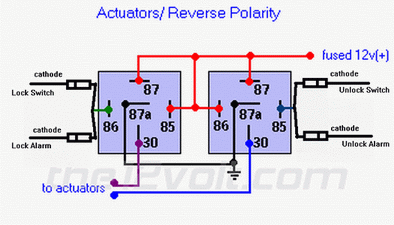

I was thinking about your problem today and came up with an idea cut the pink wires and wire them to a reverse polarity configured relay pack so that your alarm runs your locking then wire the switch back in so that it only outputs a ground when pressed and wire this to the negative alarm wires so that instead of the switch running the actuators it runs the relay pack which inturn runs the actuators Aussie Ford capri Door Locks - Page 2 -- posted image.
you may not need the diodes see how you go

sorry dude didn't read your last post before i sent that one congrats on getting it to work

Thanks for your help///////i will try this if i have any neg feedback into the alrm problems
thanks
