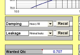

stuffing your sealed boxes -- posted image.
This is a snapshot of a part of the Unibox program.  The damping factor shown here can be scrolled from no fill, minimal fill, walls covered, to heavy fill.  Each choice changes the absorption characteristic of the box with a given value for Qa.  The program accounts for this characteristic when plotting the response.
