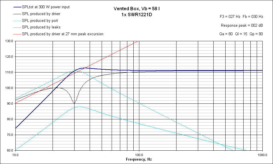

I'm going to build a ported box for a 12" Alpine SWR-1221d.
I've tried modeling up different boxes in WinISD. But to be honest, I'm really not totally sure what I'm looking for. I read through the Getting started thing. But I'm still kind of lost. After reading it, I messed around for a while, and came up with a 1.75ft^3 box tuned to 43hz. Is that anywhere near what I'd want?
I would really appreciate it if someone else tried modeling this up, and helped my with the volume/tuning freq of the box.

I took a look at that.  Tuning freq should be low, because the Fs is low at 27 Hz.  The good thing about this sub is that you can actually come up with a smooth curve.  Here is a graph of a good way to do this box:
vb_response_swr1221d.gif  (wait a few seconds and click the icon that appears in the lower right corner to enlarge the graph)
The box is just a hair over 2 cubic feet net (after displacements), port diameter is 4.72 inches, port length is 22 inches.  Tuning frequency is 30 Hz.  Use a small amount of polyfil in the box and one port.  You can convert the port to a slotted type if you wish.
This is a DVC 2 ohm woofer, so I figured that the coils would be wired in series for a total 4 ohms.

Thanks for the quick reply. However, I'm still somewhat lost. Why do you want to try to get the curve as smooth as possible? Just so it'll play all frequencies at close to the same volume?

Posted: August 05, 2005 at 1:14 AM / IP Logged
Yes, you want to avoid peaks in the response.  The only time peaks are in demand is when you are specifically tuning for SPL (competition).  And keep this in mind:  the car's cabin gain will peak the response and that is not shown in a computer mockup.

No, what I mean is, what does the smooth curve mean to me? That it'll play all frequencies at close to the same volume?

Another question I have is, in a post from Alpine Guy, he said (talking about his Type R) "... Iv had box's made for me with 2 cube's of air space and tuned to about 45hz, it was stupid loud..."
My question is, how did tuning it to 45 hz make "stupid loud"? Are most bass notes in music closer to 45hz than 30hz and that's what makes it play louder?

Posted: August 05, 2005 at 1:34 AM / IP Logged
Yes, the combination of the box tuning and the car's cabin gain.  But the majority of well-recorded music sources would benefit greater with a response curve that mimics the response of a sealed enclosure...only the ported box is going to provide a greater response in the low freq range.  If you are building for the purpose of enjoying music, build with the idea that you want to extend the freq range as low as you can.  On the other hand, if you are building with the idea that you want the most popular mass-recorded beats to hit harder than everything else to the point where they become the primary focus of your sub...tune in the 40s up to 50.  That is the primary difference of SQ vs. SPL.
