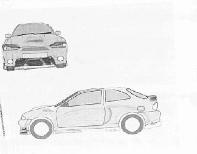

I am in the process of drawing designs for my custom bodykit. I want to make my own style fender flare to suit my application, my question is how would I make a strong solid piece from a mold? Would i fill my whole mold w/ resin and let it cure or would i throw in a lot of pieces of fiberglass mat in the mold along with the resin?
fiberglass fender flare -- posted image.
