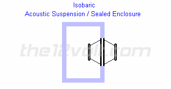

Doug, in your previous post you were referring to an isobaric configuration as series. These are two very different things. Series is a wiring configuration between two or more speakers and/or voice coils. An isobaric configuration is mounting two woofers as shown below. Just to make sure we're all on the same page which of these two are you referring to?
Better Sound -- posted image.

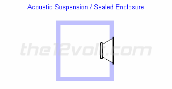

If you're wiring two or more speakers or voice coils in series (higher impedance, more resistance), the amplifier will not run as hard as it would if they were connected in parallel (lower imepdance, less resistance). If you were to mount the woofers in an isobaric configuration like above, you can get away with using a much smaller enclosure, but will not have the same amount of air movement (output) as you would if you mounted each in it's own enclosure or in a typical fashion as shown below.
