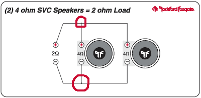

4 ohm SVC Parrallel wiring -- posted image. can anyone tell me how i can join the wires where they are supposed to. (in the red circles) any info at all will be much appreciated. cheers

really depends on what kind of terminals you have on the speakers, if they are push ones just twist both wires (one incoming one outgoing) together and jam them in there, if it has spade terminals just solder both wires onto the terminal.  Cant think of any other common ones but just remember what you are looking for is strong solid connection of two conductive materials (the wires of course), so if its some weird sort of terminal just be creative;

There's an answer or two IN THIS THREAD that explains why diagrams are shown like that.  You just should know that a connection between two or more wires can take place either at the terminal or on the wires themselves.

stevdart; that link helped me alot it has now solved my problem, cheers
