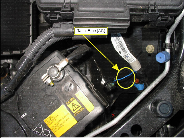

Im trying to install remote start on my 2003 honda civic lx coupe.  Ive got the remote start to work but the starter wont disengage, I was thinking probably because its hooked up to voltage sense.?.  I need help locating the tach wire cause i cant find it.  Ive heard a 2 pin connector on the passenger side by the battery, but cant find it.  Need a little help here.
thanks, CsC

Tach SignalBLUE2 PIN CONN BY BATTERY *
* Alternate Tach Signal At 8 Pin Grn Conn At Underdash Relay Box

Also, at the fusebox under the dash near the top. There is a 14pin or so connector.... at the right end of it, there is a blue/white and a blue right beside each other on the top row. Tach is the blue (the blue/white is vss, BTW).
The One under the hood is right beside the battery, taped to a harness, one blue wire by itself in a 2pin plug with a rubber boot on it. You should see it if you look down the fender side of the battery, behind the passenger headlight.

can anyone get a picture of the location?

thanks for the pic im going to look for it right now

hell yeah i found it thanks to the pic, thanks peeps
