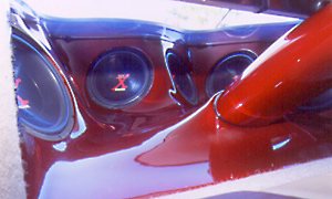

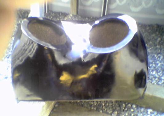

This is kind of what I'm going for more like the black enclosure with the 2 subs, any help  on how to do it just like this would really help.
how do I fiberglass enclosure? -- posted image.

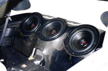

WOW Sorry, huge pic, here it is hope this works better

Yer aluminium foil works great, cept it can stick to the enclosre, i dont use foam though.  what you do is make all the flat areas outa MDF and glass onto the MDF for joins.  use dowel rods and hot glue to hold the speaker rings in place.  The you apply fleece to the enclosre and glass
Check out this link its a good site, this is how i did my box, cept i used a flat MDF front and used glass to make a mould of the side of the cars boot
http://web.njit.edu/~cas1383/proj/Glassing2/index.htm
http://web.njit.edu/~cas1383/proj/Glassing1/index.htm
good luckbreglassing is quite easy once u get the hang of it
