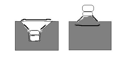

A pic I made for another subject but similar to this (I like to bring out old pics)...
Downfiring sub? -- posted image.
...because I like illustrations.  But this is to show that these two woofers are firing at 90 degrees from each other.  Reversing the polarity of one of them still results in a 90 degree difference.

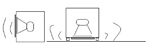

This is one up, one down:
...again, old pic drawn to show the difference in airspace in the boxes, but it works for this subject.  One of these could be reverse-wired and they would both fire in the same direction simutaneously.
And, of course, two woofers facing the same way and wired the same will fire simutaneously in the same direction.  Just said to finish the thought process...
So, knowing these things, you know what obstacles you would face if you faced your woofers at 90 degrees apart.
