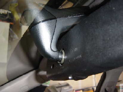

thanks gus, i was thinkign about that, the clifford actually has a unlock signal coming from the intellistart module to provide an unlock before starting. guess i have to hook it up now. unless i find away to stop the factory alarm from triggering. BTW if anyone is looking for a cool place to mount the led in an audi and is patient, the picture is where i choose to do it. Remote start in Audi a4 2001 not working -- posted image.

I thought about that in my 2004 VW.... but then had the even brighter brainwave of pullin the alarm LED wiring into each door, replacing the OEM red LED with a nice bright blue DEI LED, and filling in the holes where the plunger used to be on both doors..... looks good, and I don't have to listen to the useless plungers rattling.
