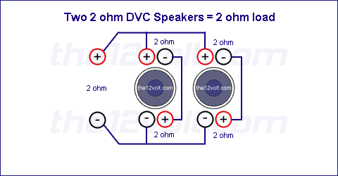

If I have a mono amp and 2 2ohm subs, How would I wire them to run on 2ohms? Subs are L'5's

First of all I already showed you to figure it out, but I like repeating my self so here is where you can do it,  https://www.the12volt.com/caraudio/woofer_configurations.asp.
Secondly, from the other post https://www.the12volt.com/installbay/forum_posts.asp?tid=64509&PN=1, it says you have dual two ohm subs. There is a difference between a dual 2 ohm and a single voice coil 2 ohm sub.

Here, so no questions will be asked.... How to Wire Two 2 Ohm DVC Subs to 2 Ohms? -- posted image.

are you sure those aren't the dual 4ohm L5s wired into 2ohm?  IF they are, your choices are either 1 or 4 Ohms.  I have 2 L5s in my ride, and I use separate amps for each.
