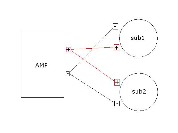

Connecting in parallel is just as geepherder said.  I will try to illustrate.
    +  _______________  +  __________________  +
AMP Inputs                       1 woofer                              2 woofer
     -  _______________  -  __________________  -
I think I got the illustration right.  Someone correct me if I am wrong.
That's my opinion. Take it, leave it, or correct me.
lookingforcool
Member - Posts: 21
Joined: November 24, 2004
Posted: October 27, 2005 at 11:14 AM / IP Logged
i think it's something a little more like this, actually:
what is a mono amp -- posted image.
