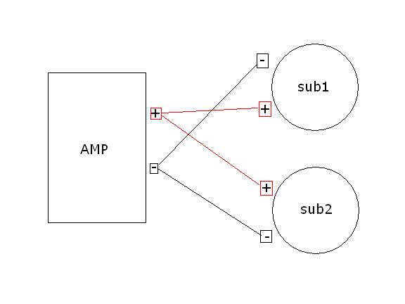

thanks arrow what does wired in parallel mean
new to the stereo world
geepherder
Platinum - Posts: 3,668
Joined: October 27, 2003
Posted: October 26, 2005 at 8:46 PM / IP Logged
It basically means connecting both subs directly to the amp, positive to positive, negative to negative.
The alternative would be in series- you would connect them in a string- from the amp, to one woofer, out that woofer to the other woofer, back to the amp.
The load placed on the amp is different depending on which way you connect them.
arrow12
Silver - Posts: 527
Joined: October 06, 2005
Posted: October 26, 2005 at 9:51 PM / IP Logged
Connecting in parallel is just as geepherder said.  I will try to illustrate.
    +  _______________  +  __________________  +
AMP Inputs                       1 woofer                              2 woofer
     -  _______________  -  __________________  -
I think I got the illustration right.  Someone correct me if I am wrong.
That's my opinion. Take it, leave it, or correct me.
lookingforcool
Member - Posts: 21
Joined: November 24, 2004
Posted: October 27, 2005 at 11:14 AM / IP Logged
i think it's something a little more like this, actually:
what is a mono amp -- posted image.
