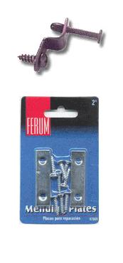

I have used items similar to these...usually the metal mending plates stretched across the corner of the plexi so it cannot be seen.
Amp rack plexi glass window how to -- posted image.
