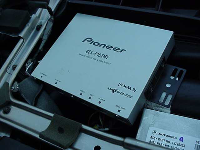

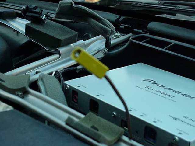

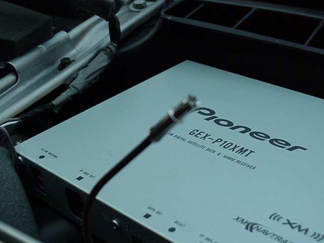

Well, I am using the factory XM antenna now as suggested "dsime".   After dropping the headliner and unbolting the factory antenna I could see that this was going to be a little more involved than I would like.  Anyway, the XM radio is located below the glove box (2005 Tahoe).  The antenna is a single brown wire.  Simply remove the yellow plastic cover and plug into the Pioneer GEX-P920XM (see photo).
I removed the upper dash trim panel and mounted the GEX-P920XM underneath.  This is the easiest way I've found the work on the entire install, not difficult to remove and opens everything up so wires can be secured properly.
George

Posted: November 14, 2005 at 8:47 AM / IP Logged
Correction: GEX-P10XMT
Photos:
AVIC-D1 Antenna ? -- posted image.
