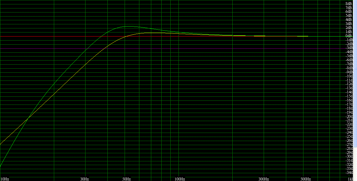

Anywho, all graphed out for ya:
The green line is the ported box @ 1.75cft @ 28hz and the yellow is a sealed box... notice the steeper slope.
Notice too that these graphs *do* indeed have a simaler shape.. they won't sound all that different. Still, the +3dB down at 30hz easily would seal my decision on the matter.

Ok.  It makes sense now.  It really helped seeing the graph.  So the advantage of a sealed box is to provide a more flat even response without peaks across the entire range the subwoofer plays, right.  However, it will sacrifice a small amout of SPL, correct.
