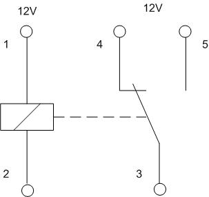

Hi there,
Brand new, First Post, and limited knowledge.
I have purchased a relay (its nice and small), the planned purpose is to use my existing low beam signal to power up my HID light. This application is for a 2005 Honda Motorcycle.
Can someone tell me what lead to which pole?
I am assuming i will have the following:
Signal power in.
Main Power in.
Main power out.
Can someone also tell me what im missing because there are 2 poles left.
HID Relay -- posted image.
Thanks

yup i read that before i posted, still haven't discovered the answers i was looking for.
I am assuming that i hook up:
main power in to pole 1
main power out to pole 2
signal lead to pole 3
but what are my connections to poles 4 & 5

You want:
Signal 12v to #1
Ground to #2
Main 12v Power in #3
Main 12v out to light #5
sixgill
Joined: November 18, 2005
Posted: November 18, 2005 at 4:46 PM / IP Logged
Thank you very much.
