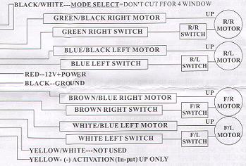

I've got a 97 Chevy Tahoe LT 4WD 4 Door that i just installed a Autopage RS-855 everything seems to be working great now i need to get some info on what Colors go to what (See Picture) and where the wires are located at to make the connections for my Window Roll Up Module that i just got i attached a Image of the installation instructions so once again any help will be greatly appreciated

Reversal Rest At Ground Power Window Circuit
Window UpDriverF\ D BLUE
PassF\ L BLUE
DriverR\ D GREEN
PassR\ L GREEN
@ MAIN SWITCH
Window DownDriverF/ BROWN
PassF/ TAN
DriverR/ PURPLE
PassR/ PURPLE
MO

Thanks for your response mo12v, do you know if i have to make the connections at the Actual switch and on the actual motors as it says on the Diagram or is there any other way to make the connections (Driver Side Kick Panel etc.) ???

You'll have to make you connections in the drivers door for at least the drivers window.  You MIGHT be able to pick the other windows up in the drivers kick, I stress the word might  since I haven't played with one of those trucks in a couple years.
