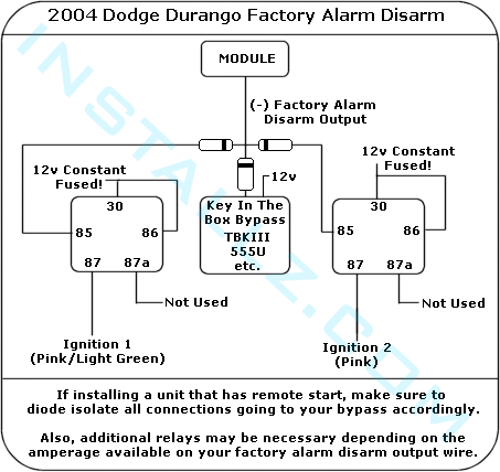

As he said there is no disarm wire. Don't use the OEM remote or lock the doors with the door open and the OEM security shouldn't arm. If it comes down to it you will need to energize the ignition wire and your bypass when unlocking to disarm.

You may have to fire up the ignition, accessory, AND bypass wires. Here's an example of how to do it on the durango the concept is the same just using your vehicles ignition/accessory wires..
