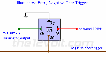

It's still need a relay too right. to get a strong ground. 2004 toyota sienna, alarm/remote start -- posted image.

Johnny, it is a low-current ground. As long as the aftermarket unit puts out a negative pulse, no relay should be needed.
