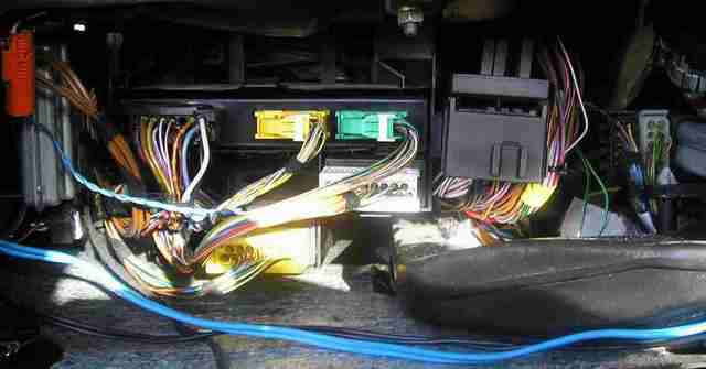

Guys still nothaving any luck, based on the only info thats available the plug i'm looking for is:
"The alarm plug is a black 12 pin plug located just behind the glove box. It is mounted with the pins facing you atop a vent just to the left of the body computer. Other wires at the alarm plug are: 12V- RED / white; Accessory- PURPLE / white; Siren- BLACK/ blue; Ground- BROWN / orange.
Power LockWHITE/ red + factory alarm plug wiring diagram ’95 BMW 318 central lockin -- posted image.
Power Unlockblue/red + factory alarm plug
OK so heres my glovebox and there is a couple of plugs that match that description; the most obvious choice will be the one above the vent (white one in pic), and so i locate the WHITE/ red wire going into it, and to test it out i give a low current pulse +12 which should make the door locks shoot down right? well i got nothin.....? (this is all logic based so thas why i used a secondary +12v source.-of course grounnded to chasis with the -side.
I also got a bit frustrated and started just poking +12 V on pretty much all the other wires in each harness but I stilll got no door lcok/ or unlock happenin.
Please help somebody!!!??
If anyone has actually done this wiring successfully before pls just tell me exactly where the right connections are based on my pciture,
Cheers!!!
fat nick

try these directions its for the UK model
POWER LOCK     pin 17     +     yel or pur plug, glove box
POWER UNLOCK     pin 4 or pin 19     +     yel or pur plug, glove box
also here is cobra's instructions which are different. hope one of these help
bmse398gbb.pdf
MATE YOU ARE THE MAN! ..all i needed was that simple information and you've saved me so much f%#king about (i was halfway thru redesigning my own 5-wire 2-Relay pos trigger system just to overide the stock door control system that has evaded until now, thank god I didnt have to do same major surgery on electrics...)
