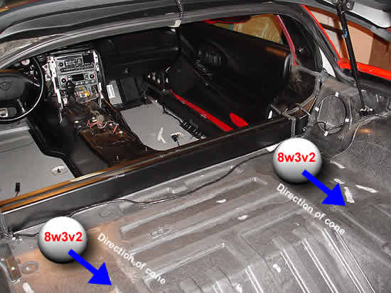

It's interesting that you mentioned the new idea. I have looked over the entire car with my co-installer, and we've decided to put the 8" absolutely NOWHERE near the front of the car. We're actually going to put them at the corners of the trunk (about 1 foot behind the back of the seats). Take a look at the layout pics:
Active Crossover? - Page 2 -- posted image.

Won't they just cancel eachother out that way?
