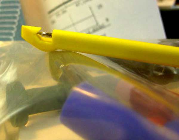

Finding wires - Page 2 -- posted image.
This is a closeup of the business end of the probe-
It has a nice wedge taper to slip inside a bundle of wires, then you just push the spring loaded release in the rear of the probe, turn it sideways and hook the wire you want to probe, pull back lightly to keep the wire centered in the V-groove, release the probe, and the spring does the rest. With the banana jack on the end, you can hook it up to your DMM with a dual banana plug test lead.
The tip is nicely centered in the V-groove, so it can work with thin gauge wires as well as thick ones.
If you have unusually hard insulation, it helps to rock it back and forth a couple times to help the tip penetrate the insulation. With the kinds of wires you'd typically be dealing with for automotive installations, this is a one handed affair.
I got that five pack, but you really only need one, because I figure just one should last forever with reasonable care (such as using it for voltage and resistance probing only, not pushing high current through it, where you run the risk of melting the tip). Worth having the spares in case it gets lost somewhere though.
Afterwards, a little massaging of the insulation leaves virtually no trace. If it's an exterior wire, you could apply a dab of sealant to make sure you haven't given corrosion a toehold.
Try it, you'll like it.. nifty-
