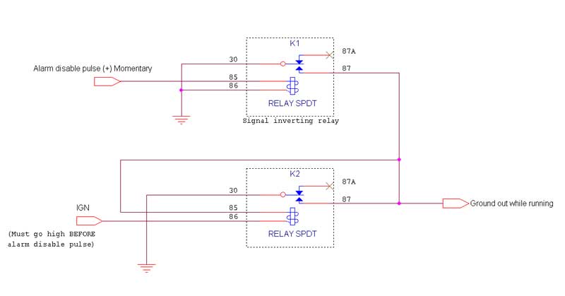

Could try this-
No Ground While Running Output -- posted image.
You just have to make sure the ignition power comes up before the momentary pulse is issued, otherwise it won't work. You could substitute a transistor for the first relay, but this would do
jayyzr
Copper - Posts: 114
Joined: May 14, 2004
Posted: December 27, 2005 at 2:11 PM / IP Logged
Thankyou for all the input on my question, I did have a extra 3rd ignition/2nd acc wire that I used to wire the relay up for the ground while running and it worked perfectNo Ground While Running Output -- posted image. Thanks alot
