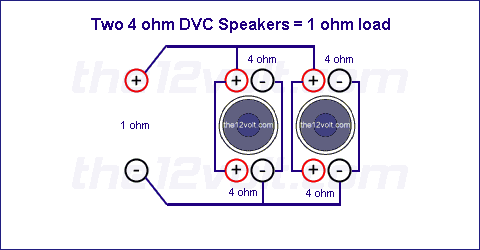

I'm guessing that would be the better choice? I'm using this image as reference...
amp/sub combo -- posted image.
According to the top image, the a8002t amp would be putting out 800 watts at 4 ohms, correct?

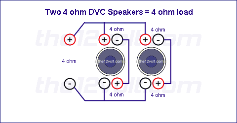

Well here are the two options you will have with your dual 4 ohm subs...
OR
You will not be able to achieve the most common 2 ohm setup that most class D sub amps are optimnized for. However a nice two channel amp that is bridgeable will you suit you well. I might add that the audiobahn amp you have chosen will not produce the listed power, so steer very clear of that brand, please.
