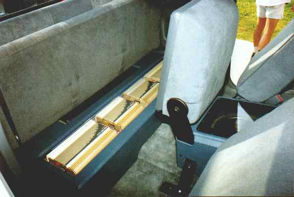

Yes, they surprisingly work well. I used two pair of them along with a 10" woofer in this Dodge Ram:
https://www.the12volt.com/installs/ram2.jpg
They made a pretty big difference while in the truck, but once you were no longer touching the truck, the sensation of bass disappeared. You could definitely feel them.
