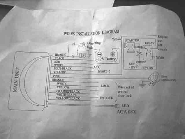

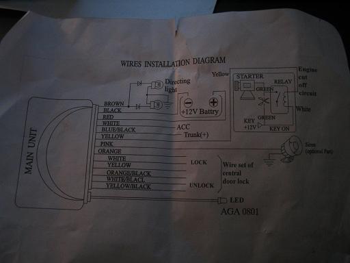

You didn't hook up the yellow wire from the top of the "WIRES INSTALLATION DIAGRAM" to 12V, did you? That's a relay control signal for the starter cutout; connecting it to 12V will blow it-It looks like the WHITE wire is for LOCK, where does the light blue show up?
