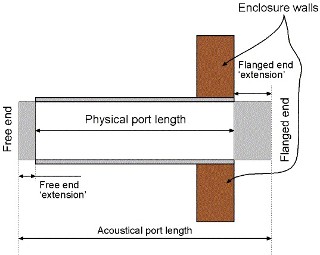

Here is an illustration taken from the WinISD help section that shows the port's function:
Port Angle -- posted image.
You see that on each end of the actual port tube there is a space of air that is called an "extension".  These extensions are part of the port's function, too, and the entire length is the actual acoustical port.  I don't know that cutting the ends at a sharp angle will not interfere with the tuning.  I haven't experimented with doing it myself.
You should, or could, figure out a way to make an opening between the cabin and trunk so that the complete sub sound will more easily get through to the cabin and sound louder.
