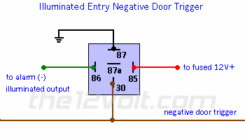

I just wanted to make sure I was doing this right, I have a 03 Forester and the Viper 791Xv, I want to hook up the domelight supervision, (wasn't hooked up at time of install) According to the wiring diagram it's the yellow- wire coming from all doors, except the drivers door which shows to be BLU/ORG, so, would this be correct:
86 to H1/4 BLK/WHT
85 to 12V constant
87 to ground
30 to -yellow (or would the blu/org work also?)
03 Forester 2.5X/Viper 791XV -- posted image.
Thanks for any help or advice.
Les

Use the yellow.  If you used the blu/org, when you have your key in the ignition and the dome light supervision is on, the bell will chime  (because the car thinks the driver's door is open).
