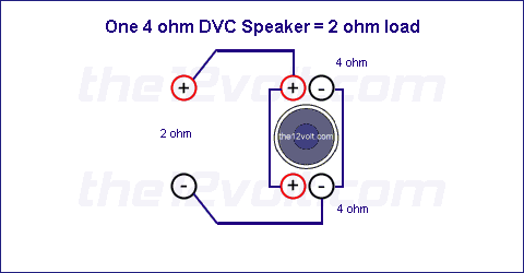

I want to get my amp to one ohm so I can have it at 1000 wat for my alpine swx1042. how would i do that? i forget its been awhile ..

Your amp doesn't "go to ohms", your subs or speakers present resistance or an ohm load to the amp.
Unfortunately you will not be able to achieve a 1 ohm load with a dual 4 ohm sub. Your best bet and really only other ideal option is to wire in parallel setup to present the amp with a 2 ohm net impedance.
How amp to 1 ohm -- posted image.
