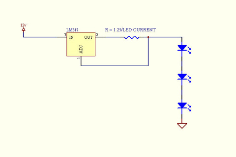

You could simplify things by using one or two Lumileds LXHL-LD3C leds. Use a constant current regulator as shown in the picture.

Forgot the picture.
building led tail lights, 93 Mustang -- posted image.
