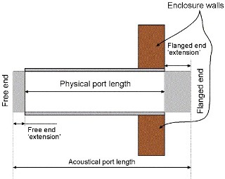

Here's a pic taken directly from the WinISD Pro help file.  This is from the newest alpha version that's been out for a couple of years:
Designing vented enclosure -- posted image.
The amount of space at the ends of the actual, or physical, port is basically an unknown factor.  You just need to use some rules of thumb:  on the inside, leave at least the diameter of the port.  On the outside, leave at least that amount of room as well.  Those airspaces act as functioning parts of the overall port length but are not figured in port length measurements.  The program looks at the end of your port by what you input into the "End correction" box under the "vents" tab.  The 0.732 that you see in the window is the default and works with most port installations, and should work with yours.
