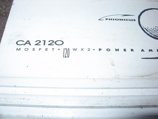

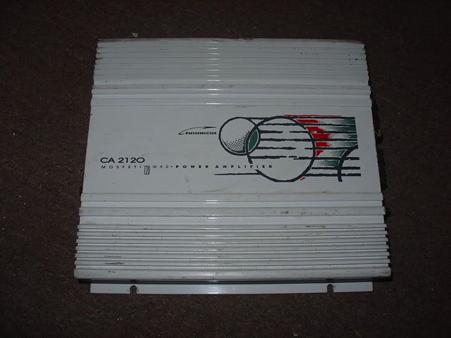

now the amp was also from the previous owner, and i have no clue what type it is or whatever, it was just there, he siad he was using it to power his speakers and never ran a sub, not sure if that matters, it also says 120w x2 on the cover

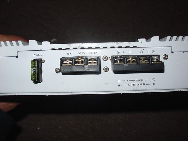

the sub has all of these connections
subwoofer and amp dont work after hook up -- posted image.
-power
-ground
-remote
-1 white RCA
-1 black RCA
-left speaker -
-left speaker +
-right speaker -
-right speaker +

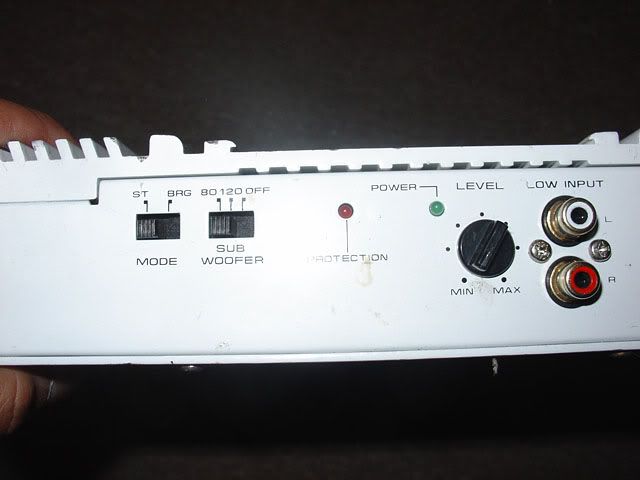

and it also has these settings
-subwoofer level: 80, 120, "subwoofer off"
-mode: st, brg

i hooked up the power, ground, remote accordingly, and also the RCA cables, the power cable near the battery terminal didn't have a fuse in it, so i put in a 25amp fuse, the amplifier itself has a 30amp fuse in it, and it's still good
then i took regular speaker wire and i connected the subwoofer + to the "left speaker +" and the subwoofer - to the "left speaker -"
then i turned on the radio to see what was up, the amp turns on, and the subwoofer turns on about 1 second later, and i hear the subwoofer bump once, then the rest i hear is slight low volume thumps, it is always in the same pattern, bump..bump..bump..bump.. and it just keeps going when i play music, then if i turn off the radio, the subwoofer turns off and i hear a small thump before it goes off, also the subwoofer doesn't bump to the music at all

-what should i set the amplifier to? ST or BRG?
-what subwoofer level should i set it at? 80 or 120?
-would a different amplifier with more power solve my problem?
-the protection light comes on with the amp, i'm not sure what that means

i would start of testing the wires the previous owner left there. Check 'em all with a DMM.
Next, (if your amp is stable) bridge your sub wiring,   (sub + to amp left + /  then sub - to amp right -)
Set your amp to bridged.
Hope this works out, just check wires first.
