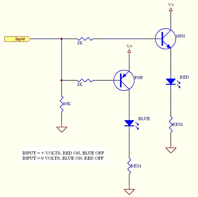

Posted: February 09, 2006 at 7:37 AM / IP Logged
Transistors to switch leds on/off -- posted image.

what is PNP and NPN ?
Basically,
PNP, 0 or -volts on the base switches the transistor on.
NPN, + volts on the base switches it on.

I think I understand.  I'm new to reading these schematics.

Thanks for the diagram, but I think that works in the opposite way to what I want.
When 0v from the input, red should be on and blue off.
When theres 12v from the input, it should be blue on and red off.
Should i just swap the PNP and NPN transistors around?

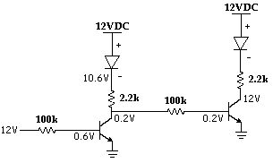

Also, I've been trying to make this but with no luck. would I need NPN transistors for this schmatic?
Thanks for your help!

Try this.

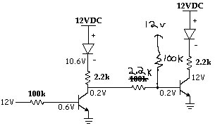

Probobly not enough current to the bases to forward the transistors. Try a pull up on the base of the second transistor. Might also want to lower the resistance of the base resistors to get more current through the base. You can go all the way down to the hundreds without damage.
Yes those should be PNP. Recommend 2N3904.
Also, if the input to the base of the first transistor floats when not connected to 12v you will need put a pull down resistor on it. If you float a base its anyones guess what state of saturation it will be in.
Your right, opposite.
Swap the leds, not the transistors.

firstrax wrote:
Those should be PNP. Recommend 2N3904.
I meant to say NPN.
