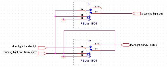

It sounds like your parking lights are pulling more current that what the diode is capable of handling.
Use two relays one for the parking lights and one for the door handles. That way you won't need the diode as the relays will keep the circuits isolated from each other. And will prevent the parking lights from turning on when the door handles light up( I'm assuming that the door handles come on with the dome light) and vise versa.

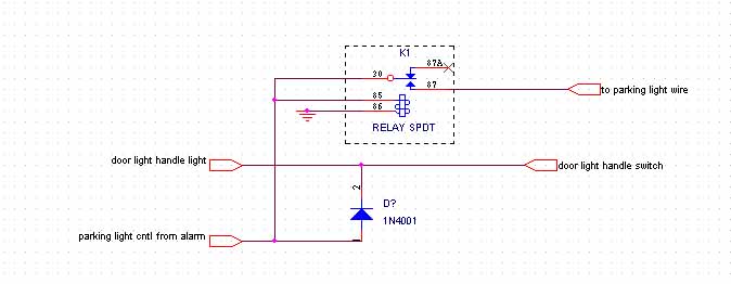

Posted: February 10, 2006 at 9:55 AM / IP Logged
Yeah, sounds you were using the diode to power the parking lights, which isn't the best way to go; you'd need a hefty diode to handle the current- diodes should generally be only used for signal isolation, and not used for high power control for things like parking lights.
Add a second relay as mentioned-
What kind of diode to use? -- posted image.
If the door lights use less than an amp, and the original door light switch doesn't maintain a ground on the line you might be able to use a diode for that, if you don't have a second relay.

stonecole
Copper - Posts: 50

stonecole
Copper - Posts: 50
Joined: October 30, 2005
Posted: February 10, 2006 at 11:07 AM / IP Logged
Dualsport,I like the two sanerios you gave I'll try one or both when I get a chance.

stonecole
Copper - Posts: 50
Posted: February 18, 2006 at 10:36 PM / IP Logged
Dualsport, I finally got around to hooking up the relays. I used the two relay diagram you provided. Works like a charm. I chose that one because the running board lights and the door handle lights are running together and I don't know how much current it's pulling.
