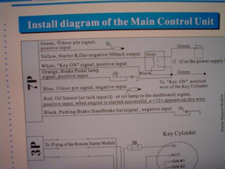

1_sick_tsi
Joined: March 08, 2006
Posted: March 10, 2006 at 5:44 PM / IP Logged
96 chrysler cirrus lx, pd-175 hook up -- posted image.
I cannot find all the wires in the car for this 7p on that website, some pointers would be helpful

awagner103
Joined: March 27, 2006
Posted: April 06, 2006 at 1:36 AM / IP Logged
Hello i just insatlled on of these pd-175 s on my 2001 mazda mpv dx. You will need to 12p  3p and 7p all conected before you get anything 12p has the  power wires for the alarm main unit ans the  door locks, 3p is the start system and 7p are the imputs for the unit so it knows what to do. The black wire need to be hooked to either the parking brake so that the unit knows that e-barke is on or connected to a constent ground your choice. then the red wire needs need to be connected to a 12v source that i hot once the remote start as successfullyt started the car. The  orange wire goes to the 12v output side of the brake pedal switch.white needs to a wire thats gets 12volts once the car is started, so the auto lock works and so the unit know when your in control and wont try to arm whail your dirveing. then blue or green depending on your system needs to attach the dooe pin curcuit so the unit knows when a door is open. now the yellow goes to the car disable, if you want to install it. Hopes this helps you let me know if you need anything else. adam 832-229-5587
