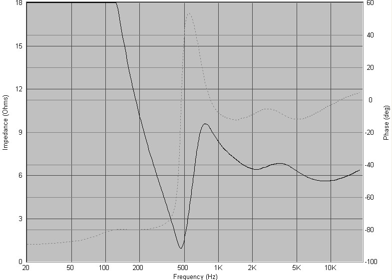

Yes, the impedance will be adversely affected.  I looked into my files and found an example to show.  This is a 3-way system impedance:  impedwithdriver.jpg  The crossover in place here was designed for the 6.5 and 4.5 woofers, and 1" tweeter for a +/-8 ohm nominal impedance.

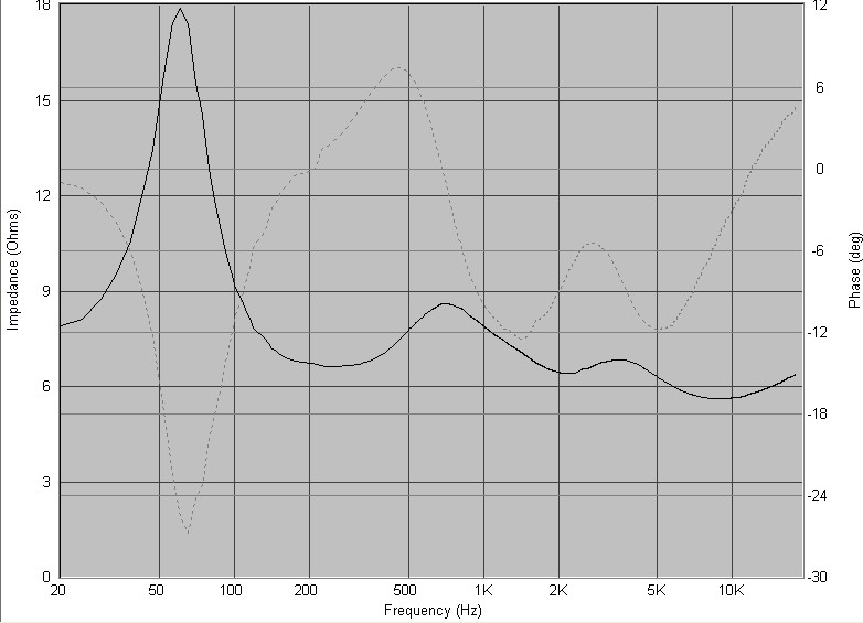

Now here's what happens if I remove the 6.5 woofer from the system:  impedwithoutdriver.jpg

Oh wow I can see the difference now.... hey thanks for digging up the graphs. My friend and I went ahead to measure the impedance on the crossover before I saw your reply, and in fact, it does change a great deal with one driver missing...
